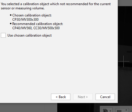

I recently updated my my gom atos 2018 to 2018 hotflix 7. But, the calibration panel i used is not there in the software. Also, when I tried to add the panel, it is not available in the dropdown menu.
Please help

you should have a file somewhere with the extension .calobj. It was delivered on the CD in the folder of your system. If you can't find it please contact your local distributor with the serial number of your calibration object.
