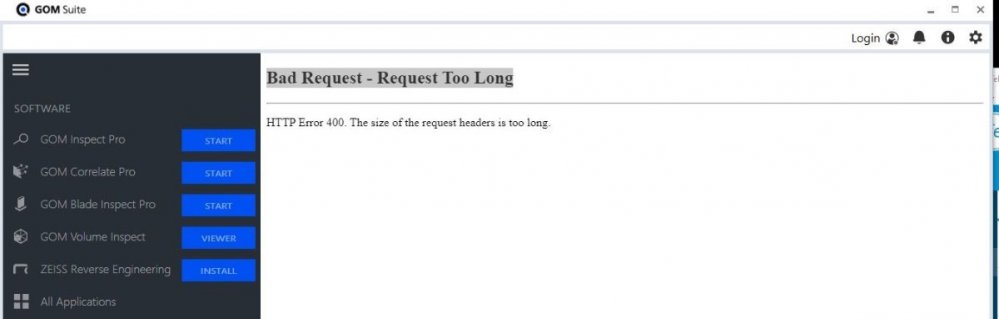

[Fa...] Posted March 31, 2022 Share Posted March 31, 2022 (edited) Hi there, I've had issue with gom Suite login for quite some time now "Bad Request Too Long" Se pic! Is there anyone who has the same problem? and possibly know how to fix it? Edited March 31, 2022 Link to comment https://qualityforum.zeiss.com/topic/737-login-error-again/#findComment-2399 Share on other sites More sharing options...
[eb...] Posted April 1, 2022 Share Posted April 1, 2022 To solve this you have to delete the Cefsharp Cache. Open (WIN + R) "Run" Menu. Enter "%appdata%". Navigate to folder ... AppData/Local/Cefsharp/. Delete the "Cache" folder. Restart the GOM Suite several times (close it in the system tray completely!) and test if you can log in now. It should work now. Link to comment https://qualityforum.zeiss.com/topic/737-login-error-again/#findComment-2405 Share on other sites More sharing options...
[Fa...] Posted April 4, 2022 Share Posted April 4, 2022 Thanks, It worked 🙂 Link to comment https://qualityforum.zeiss.com/topic/737-login-error-again/#findComment-2411 Share on other sites More sharing options...
