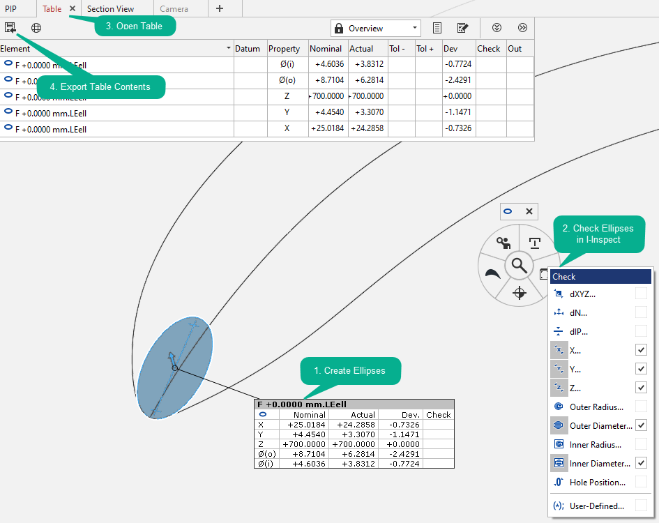

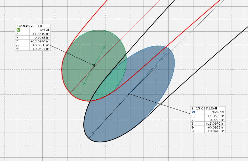

[Jo...] Posted March 16, 2022 Share Posted March 16, 2022 I am inspecting airfoil leading edge sections using the Profile Edge Ellipse command. For the constructed ellipses I would like to export the geometry information in the labels - specifically the major and minor diameter. Is there a method for doing this? Thank you in advance, Jon Bittner Link to comment https://qualityforum.zeiss.com/topic/740-export-label-geometry-information/ Share on other sites More sharing options...
[Je...] Posted March 17, 2022 Share Posted March 17, 2022 Hey Jon, If you perform the desired checks, you can export them from the table (e.g. as csv). I hope this helps, if not just let me know. Jens Link to comment https://qualityforum.zeiss.com/topic/740-export-label-geometry-information/#findComment-2270 Share on other sites More sharing options...
[Jo...] Posted March 17, 2022 Author Share Posted March 17, 2022 Thank you - I was not aware that "check ellipse" was available. I haven't used ellipses before and "check ellipses" was not listed in the direct help topics. Link to comment https://qualityforum.zeiss.com/topic/740-export-label-geometry-information/#findComment-2277 Share on other sites More sharing options...
