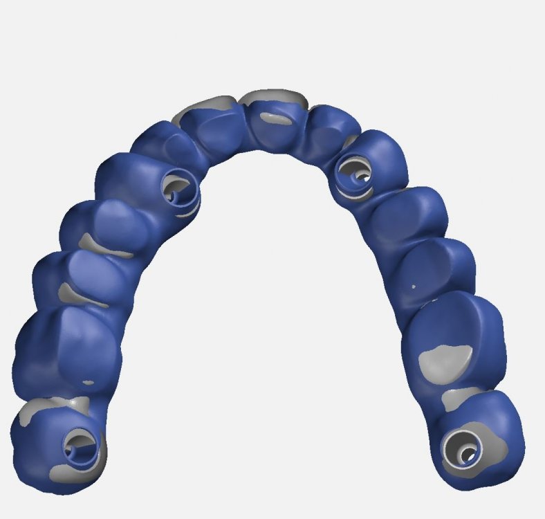

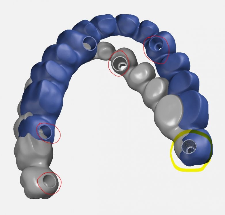

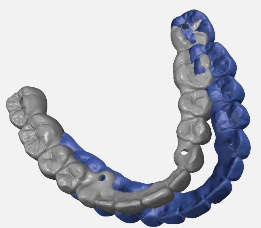

[Al...] Posted January 29, 2021 Share Posted January 29, 2021 Hi guys! I admit I am rookie and trying to use GOM for first time, saw some clips but I can't seem to figure out how to align two objects which are almost same but are of course not. What I would like to see them aligned by inner hole design and to see if there are any differences between them. All other surfaces will be different since one file is modified from another but only on the ouside aka teeth. But I want to check if holes are perfect match or not but GOM won't align them...any idea how to do it? TIA.. I hope from photos you will understand what I want to align... Link to comment https://qualityforum.zeiss.com/topic/75-aligning-stl-objects-with-only-few-same-spots/ Share on other sites More sharing options...
[Na...] Posted January 29, 2021 Share Posted January 29, 2021 Hello Ales, in principle you need to align a nominal element with an actual element. You could create cylinders on your nominal part and on you actual part and click on the plus sign on the top right and chose alignment by geometric elements. However, all cylinders are nearly parallel, which means not every degree of freedom is blocked. You could try to create a point in each cylinder (section point from a plane and cylinder axis for example). With points you can use an RPS alignment for example. Are you screenshots after the prealignment (also available on the plus sign)? Regards Nanno Link to comment https://qualityforum.zeiss.com/topic/75-aligning-stl-objects-with-only-few-same-spots/#findComment-197 Share on other sites More sharing options...
[Al...] Posted January 29, 2021 Author Share Posted January 29, 2021 This is prealigment.... Link to comment https://qualityforum.zeiss.com/topic/75-aligning-stl-objects-with-only-few-same-spots/#findComment-198 Share on other sites More sharing options...
[Na...] Posted January 29, 2021 Share Posted January 29, 2021 Please try to construct -> Cylinder -> Nominal, measuring principle fitting Cylinder (On the blue nominal part). Or are those cones? Are there some flat areas on the backside? This would help with creating points at a specific distance to the plane on the cylinder axis. Link to comment https://qualityforum.zeiss.com/topic/75-aligning-stl-objects-with-only-few-same-spots/#findComment-199 Share on other sites More sharing options...
