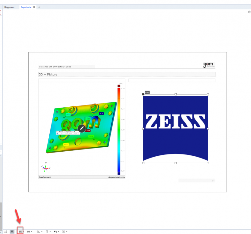

[Ri...] Posted April 5, 2022 Share Posted April 5, 2022 Hi I`m making a report with a detailed area of a mold. I wanted to add a full image aside of it to be more understanding to what detail is being scanned. Is that possible? on the side of the information table? Link to comment https://qualityforum.zeiss.com/topic/797-report-with-more-images/ Share on other sites More sharing options...
[a9...] Posted April 12, 2022 Share Posted April 12, 2022 Hi Ricardo, Do you want to do something like shown in the picture below? I created a report page with valuable content on the left (surface comparison of part) and a custom image on the right. I selected the template "3D + 3D" as a starting point and added a picture to the right with the marked menu. Best Regards, Matthias Link to comment https://qualityforum.zeiss.com/topic/797-report-with-more-images/#findComment-2503 Share on other sites More sharing options...
