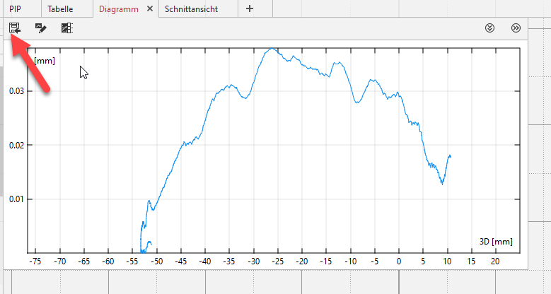

[Ya...] Posted April 6, 2022 Share Posted April 6, 2022 Hi all, I am new to GOM and I want to know please how can I export the strain results after the analysis is completed ? Thank you Link to comment https://qualityforum.zeiss.com/topic/805-how-to-export-strain-measurements/ Share on other sites More sharing options...
[Na...] Posted April 13, 2022 Share Posted April 13, 2022 Hello Yazeed, a simple way to export the result with the help of the diagram: Regards, Nanno Link to comment https://qualityforum.zeiss.com/topic/805-how-to-export-strain-measurements/#findComment-2511 Share on other sites More sharing options...

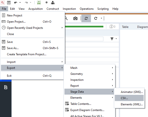

[Th...] Posted April 21, 2022 Share Posted April 21, 2022 Dependent on your license you can also get full field results e.g. by selecting the element(s) to export in the explorer an choose "File -> Export -> Stage Data -> CSV..." Link to comment https://qualityforum.zeiss.com/topic/805-how-to-export-strain-measurements/#findComment-2567 Share on other sites More sharing options...
[Be...] Posted April 2, 2024 Share Posted April 2, 2024 I observed that this does not include the data within the surface. It only exports the strain data at the boundary of the surface components. How can I make it export the entire field.. Link to comment https://qualityforum.zeiss.com/topic/805-how-to-export-strain-measurements/#findComment-11116 Share on other sites More sharing options...
