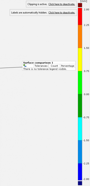

[Ca...] Posted April 22, 2022 Share Posted April 22, 2022 (edited) I am looking to produce a table that shows how many points on a surface comparison sit within my tolerance bands. (Example table below) - How can I extract the necessary data from a surface comparison to complete this table - Is there a fast way of doing so which can create a table like this automatically based on the tolerance bands in my colour legend. Range (mm) # Points % Lower Upper -2 -1.5 403 0.05% -1.5 -1 1302 0.15% -1 -0.5 29172 3.40% -0.5 0.5 789203 91.87% 0.5 1 35390 4.12% 1 1.5 2049 0.24% 1.5 2 670 0.08% Out of Range 887 0.10% Edited April 22, 2022 Incomplete post Link to comment Share on other sites More sharing options...

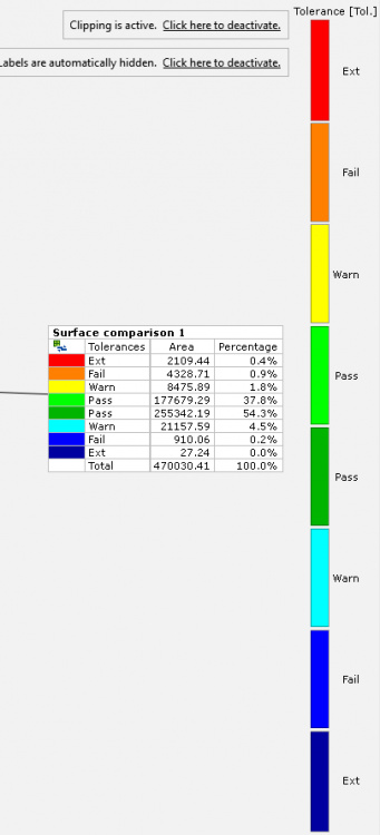

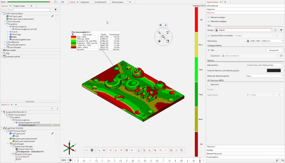

[Na...] Posted April 22, 2022 Share Posted April 22, 2022 Hello Caleb, there is a label template for surface comparisons called "Statistic" it will show you these values: Regards, Nanno Link to comment Share on other sites More sharing options...

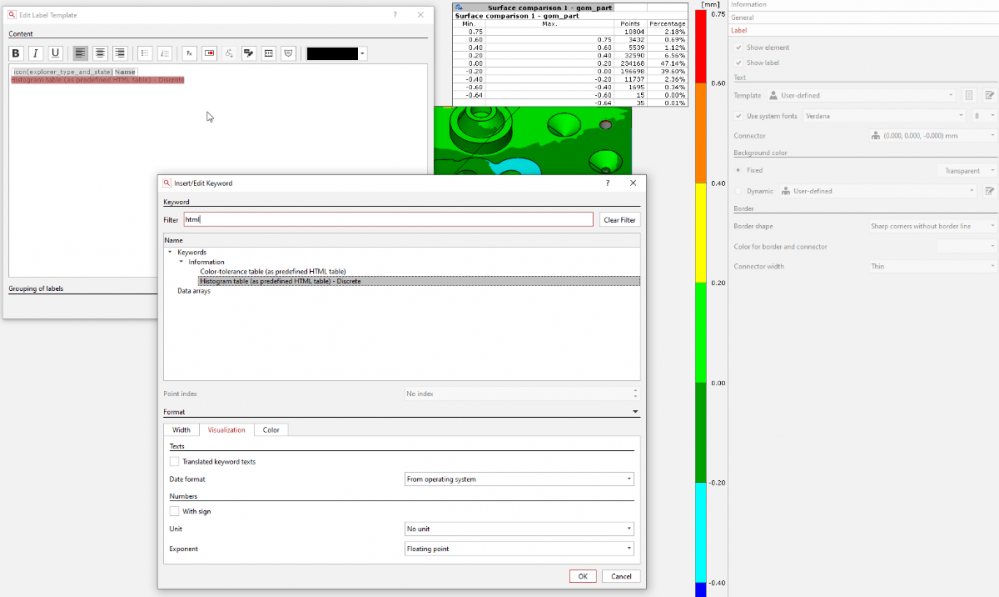

[Ca...] Posted April 26, 2022 Author Share Posted April 26, 2022 Hi Nanno, Thanks for your help. That is very helpful and will allow me to perform the checks we need. Is there is a way I can create a similar table based on the 'GOM 8 Colour' legend instead of the tolerance legend? The GOM 8 colour is just a bit easier to work with and create bands for, and displays it in a more suitable way. Regards, Caleb Link to comment Share on other sites More sharing options...
[Na...] Posted April 26, 2022 Share Posted April 26, 2022 Hello Caleb, there is a keyword, which will work with the GOM 8 Colour template. You can edit the label and insert it with the "Fx" button: Regards, Nanno Link to comment Share on other sites More sharing options...
