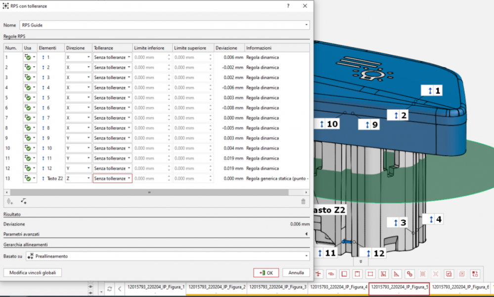

[Ma...] Posted April 26, 2022 Share Posted April 26, 2022 If I have 2 (or 3) points that in the CAD are on the same Z, but in different surface in the same CAD, and I want to use in the aligment the measured point that have the highest coordinate in (for example) Z direction, it's possible? This is necessary because in a stage project it's possible that some cavity has the highest point A and some other has the highest point B (see image below). Link to comment https://qualityforum.zeiss.com/topic/859-2-points-and-use-the-one-that-its-the-highest-in-a-direction/ Share on other sites More sharing options...

[Ma...] Posted April 26, 2022 Author Share Posted April 26, 2022 Thank you very much! I think the solution is very good, but it doesn't work fine. See images below. Link to comment https://qualityforum.zeiss.com/topic/859-2-points-and-use-the-one-that-its-the-highest-in-a-direction/#findComment-2641 Share on other sites More sharing options...
[Be...] Posted April 28, 2022 Share Posted April 28, 2022 Hi, without the concrete data it's hard to give a good hint but the following could have happened: The introduced rule with the 'Touch disc' is a so called static rule which means that no iterative calculation of this disc could be applied during the RPS calculation. This means the surface points are used as fixed points. But if the part is moving in x and y due to the other rules in your RPS the intersection surface point can change, but for the calculation only the computed coordinates of the surface points are considered (calculated in the parent alignment). If this could be the reason, you should think of a hierarchical alignment: In the RPS alignment you can introduce both surface points as rules in Z as dynamic rule. And then you have to create a dependent further RPS alignment which is constrained only for moving in the Z-Direction with the 'Touch disc rule'. Hope this helps?! Regards, Bernd Link to comment https://qualityforum.zeiss.com/topic/859-2-points-and-use-the-one-that-its-the-highest-in-a-direction/#findComment-2703 Share on other sites More sharing options...
[Ma...] Posted May 2, 2022 Author Share Posted May 2, 2022 I tried and it gets better (not perfectly, error of 0.01/0.02 mm in some cavity), but I don't understand why I have to do 2 aligment for do this and the result anyway it's not perfect. I think GOM it's a spectacular software, but the only achille's heel are the alignments. Sometimes it's not possible to obtain what I want in a easy way, but only with different action like this. Mine it's a suggestion, improve the alignments. I had problems in the past, and this problems were not be solved because GOM can not do the alignments i want. In this case 0.02 mm of errors I think can not be accettable. Link to comment https://qualityforum.zeiss.com/topic/859-2-points-and-use-the-one-that-its-the-highest-in-a-direction/#findComment-2723 Share on other sites More sharing options...
[Be...] Posted May 2, 2022 Share Posted May 2, 2022 Hi, again, if you have a concrete data problem you can contact the professional support via your local GOM partner in your country. Without the data we can't see what you really have constructed inside your project and the 'Forum' is not the right place to discuss concrete data problems. In my example dataset the deviation is zero as expected therefore it's hard to guess what you have done differently. Please contact your local GOM partner and supply your concrete data! Regards, Bernd Link to comment https://qualityforum.zeiss.com/topic/859-2-points-and-use-the-one-that-its-the-highest-in-a-direction/#findComment-2727 Share on other sites More sharing options...
