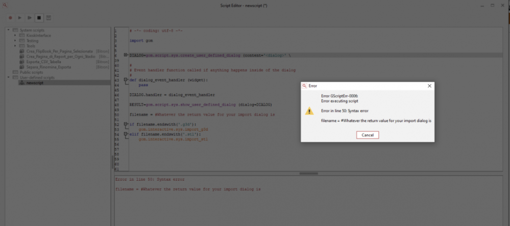

[Ma...] Posted May 9, 2022 Author Share Posted May 9, 2022 Please sign in to view this quote. Hi! I tried, but I don't know why it doesn't work. I insert a dialog for import file. This is the screenshot. Link to comment https://qualityforum.zeiss.com/topic/877-import-any-file-using-script/#findComment-2829 Share on other sites More sharing options...
[Na...] Posted May 9, 2022 Share Posted May 9, 2022 Hello Marco, there is no definition of the file in line 50 (location on the hard drive) - this should be entered in your dialog. I would recommend to have a look at our FAQ articles regarding basic scriping functions like dialogs: https://connect.gom.com/label/GKB/scripting We also have a training "Python Scripting for GOM Applications" on training.gom.com here: https://training.gom.com/course/574615 Regards, Nanno 1 Link to comment https://qualityforum.zeiss.com/topic/877-import-any-file-using-script/#findComment-2835 Share on other sites More sharing options...
[Ja...] Posted May 9, 2022 Share Posted May 9, 2022 Hi Marco, i completely agree with Nanno. I think you need to get a good base level understanding on how to work with python/gom before launching into anything with any complexity. To give short hints Things with # in front of them are comments . They will not be processed by the script They are primarily there to mark out your code for future ease of reading Does your dialogue box look correct and you are able to choose a file ? In the dialog box creator the box that has the file to choose has a name , given on the right hand side of the dialog creator. It is this name youll need to reference So lets say its name was "nameoffilepathobject" - Needed code will look something like: Filepath =DIALOG.nameoffilepathobject Im going to assume that you intend to write something that cycles through a directory to do something? This is possible , but being honest I also feel that it would be difficult to give the right level of hints through the forum and without you having a base level understanding of coding in GOM. Link to comment https://qualityforum.zeiss.com/topic/877-import-any-file-using-script/#findComment-2856 Share on other sites More sharing options...
