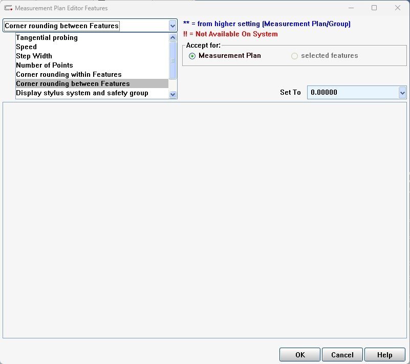

[Ri...] Posted July 15, 2022 Share Posted July 15, 2022 I'm am growing very, very tired of this new corner rounding Bull Shit! 🤬 😡 This has continued to cause stylus crashes on parts. One time it runs thru, next time it clips or out right hits the part. This is particularly the worst when approaching from Z- axis (probing the bottom of a part. Prior to this BS corner BS, I never had an issue. 🤬 😡 Link to comment https://qualityforum.zeiss.com/topic/9118-can-you-turn-off-the-new-quotcorner-roundingquot-on-zeiss-cmms/ Share on other sites More sharing options...
[Al...] Posted July 15, 2022 Share Posted July 15, 2022 Hi Rick, Do you mean the CMM is rounding corners when making clearance plane moves? Are you using Calypso 2022? Link to comment https://qualityforum.zeiss.com/topic/9118-can-you-turn-off-the-new-quotcorner-roundingquot-on-zeiss-cmms/#findComment-41672 Share on other sites More sharing options...
[Ri...] Posted July 15, 2022 Author Share Posted July 15, 2022 This is pissing me off! How the stylus approaches a feature when "Executed" and ran by program are completely different. If I select the feature. Right Click and select "Execute" it runs exactly as planned. If I run the program it will hit the part 99% of the time. Its a Space point. Its in the Z- axis The Clearance Plane is Y+ Using "Execute": Tool moves to Z+ clearance plane Tool moves to Y+ Clearance Plane Approaches Y+ Clearance Plane Value Moves in Z- axis to below the part Movies in Y- direction Moves in Z+ direction and collects the data. (Reverse order as part clears properly). Running the program: Tool moves to Z+ clearance plane Tool moves to Y+ Clearance Plane Approaches Y+ Clearance Plane Value Tool dives in Y- and Z- axis simultaneously (moves at an angle to the Space point coordinates) Tool hits part. This has been a problem from the initial 2021 version install and every update after. (7.2.12) Now I have to add CMM Position Points to prevent crashes? How do the design engineers not see this crap happening? Link to comment https://qualityforum.zeiss.com/topic/9118-can-you-turn-off-the-new-quotcorner-roundingquot-on-zeiss-cmms/#findComment-41674 Share on other sites More sharing options...
[Ri...] Posted July 15, 2022 Author Share Posted July 15, 2022 Please sign in to view this quote. Still on 2021, latest update... And yes, Calypso started this corner rounding trash with 2021. Nearly every legacy program now either has hits or clips the part multiple times. Programs that have ran for over a decade without a single incident have to be edited. 😡 This should be embarrassing to Zeiss. Link to comment https://qualityforum.zeiss.com/topic/9118-can-you-turn-off-the-new-quotcorner-roundingquot-on-zeiss-cmms/#findComment-41676 Share on other sites More sharing options...
[Al...] Posted July 15, 2022 Share Posted July 15, 2022 I've noticed the same behavior on occasion. Maybe try setting the Clearance Distance to zero, or setting it to 10mm if it's already at 0? Link to comment https://qualityforum.zeiss.com/topic/9118-can-you-turn-off-the-new-quotcorner-roundingquot-on-zeiss-cmms/#findComment-41678 Share on other sites More sharing options...
[Ri...] Posted July 15, 2022 Author Share Posted July 15, 2022 Please sign in to view this quote. I've had it at Zero. I've had it low enough to ensure the tool should be below the feature. The only time it does function 100% is when the clearance is greater than the corner rounding movement. In this particular case, there is no room for extra clearance. Prior to 2021 version, this was never a problem. Link to comment https://qualityforum.zeiss.com/topic/9118-can-you-turn-off-the-new-quotcorner-roundingquot-on-zeiss-cmms/#findComment-41680 Share on other sites More sharing options...
[Ri...] Posted November 21, 2022 Author Share Posted November 21, 2022 These settings seem to have stopped the Rounding movements. See attached image.Calypso - Rounding-off of Corners.JPG Link to comment https://qualityforum.zeiss.com/topic/9118-can-you-turn-off-the-new-quotcorner-roundingquot-on-zeiss-cmms/#findComment-41682 Share on other sites More sharing options...
[Ch...] Posted November 21, 2022 Share Posted November 21, 2022 Measurement plan editor features>Travel>Form-related travel within strategy??? Change to off. Link to comment https://qualityforum.zeiss.com/topic/9118-can-you-turn-off-the-new-quotcorner-roundingquot-on-zeiss-cmms/#findComment-41684 Share on other sites More sharing options...
[Ri...] Posted November 21, 2022 Author Share Posted November 21, 2022 Please sign in to view this quote. This isn't form related, its new in 2021 to supposedly reduce CMM travel time to a feature. The problem with it is legacy programs are colliding with the parts. In some case traveling on the outside of the part the rounding corners as an outside move, on other features, it seems depending on stylus articulation, the rounding is the wrong direction. See my highly defined MS Paint example..... 🙄 I have watched and can repeat these instances.Untitled.png Link to comment https://qualityforum.zeiss.com/topic/9118-can-you-turn-off-the-new-quotcorner-roundingquot-on-zeiss-cmms/#findComment-41686 Share on other sites More sharing options...
[Ji...] Posted October 26, 2025 Share Posted October 26, 2025 Hi Richard, Did you get any resolution on this? I had a crash on a program that was running fine. Recently I've been testing this functionality. Now, it does this big sweeping large radius motion to get to the part and is crashing into the fixture. Any ideas would be helpful. Thanks. Link to comment https://qualityforum.zeiss.com/topic/9118-can-you-turn-off-the-new-quotcorner-roundingquot-on-zeiss-cmms/#findComment-140843 Share on other sites More sharing options...
[Ri...] Posted October 27, 2025 Author Share Posted October 27, 2025 Try this. 2 Link to comment https://qualityforum.zeiss.com/topic/9118-can-you-turn-off-the-new-quotcorner-roundingquot-on-zeiss-cmms/#findComment-140863 Share on other sites More sharing options...
[Ji...] Posted October 27, 2025 Share Posted October 27, 2025 Thank you! Link to comment https://qualityforum.zeiss.com/topic/9118-can-you-turn-off-the-new-quotcorner-roundingquot-on-zeiss-cmms/#findComment-140929 Share on other sites More sharing options...
