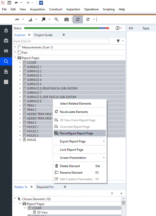

[Jo...] Posted May 12, 2022 Share Posted May 12, 2022 Hello, Is it possible to change the reference stage for an entire report and not one page at a time? Thank you, Link to comment https://qualityforum.zeiss.com/topic/944-changing-reference-stage-in-report/ Share on other sites More sharing options...
[Jo...] Posted May 13, 2022 Author Share Posted May 13, 2022 Is there any answer to this question? Link to comment https://qualityforum.zeiss.com/topic/944-changing-reference-stage-in-report/#findComment-2923 Share on other sites More sharing options...

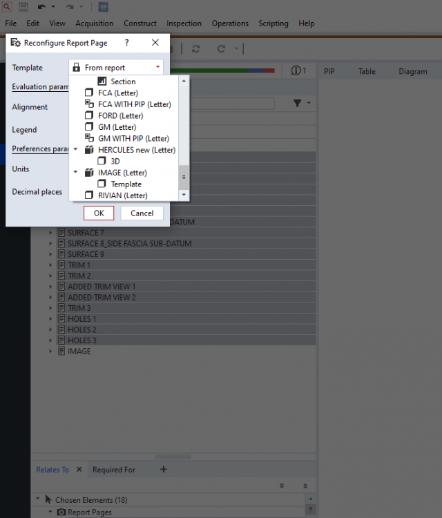

[Ja...] Posted May 14, 2022 Share Posted May 14, 2022 1. select the report pages you would like to change the template of. 2. right click an choose "reconfigure report pages" from the menu. 3. click the template window and select the report template you would like to use. Link to comment https://qualityforum.zeiss.com/topic/944-changing-reference-stage-in-report/#findComment-2925 Share on other sites More sharing options...
[Jo...] Posted May 16, 2022 Author Share Posted May 16, 2022 Hello Jayson, This does not help my situation. I have a report already generated. In this report I am using Surface Comparisons On Stage to compare several stages to a single reference stage. I need to change the reference stage and have the change propagate through the report of which I have already written. I am not able to find a way to make this change to the report. I have tried the Reconfigure Report Page option. My need does not appear to exist in this dialog. I have tried recording macros to programmatically implement the change but there appears to be no way to reference the report page numbers. I have 8 reports each with more than 150pgs and they all need to be changed. I would greatly appreciate any help! Thank you Link to comment https://qualityforum.zeiss.com/topic/944-changing-reference-stage-in-report/#findComment-2941 Share on other sites More sharing options...
[Ja...] Posted May 16, 2022 Share Posted May 16, 2022 (edited) Could you change the reference stage and then use the "reconfigure report page" with stage set to "from current 3d view"? Edited May 16, 2022 Link to comment https://qualityforum.zeiss.com/topic/944-changing-reference-stage-in-report/#findComment-2945 Share on other sites More sharing options...
[Jo...] Posted May 16, 2022 Author Share Posted May 16, 2022 This only changes the Stage that is being evaluated and not the designated Reference Stage. Would there be a way to reference the report page numbers via script? Link to comment https://qualityforum.zeiss.com/topic/944-changing-reference-stage-in-report/#findComment-2951 Share on other sites More sharing options...
[Ma...] Posted June 2, 2022 Share Posted June 2, 2022 You have to click on the stage you want to use as reference, then select the Surface Comparisons On Stage and with F4 edit it. Confirm with ok, your reference stage has changed. Recalculate all the pages. Done. Link to comment https://qualityforum.zeiss.com/topic/944-changing-reference-stage-in-report/#findComment-3131 Share on other sites More sharing options...
