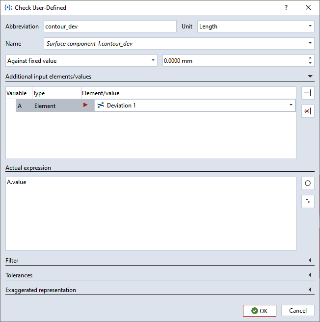

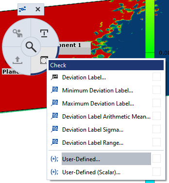

[Th...] Posted May 19, 2022 Share Posted May 19, 2022 If you end up with a deviation contour plot of a surface component, which cannot be exported by "File -> Export -> Stage Data -> CSV", you can create a user defined check to "copy" this data to a check, which can be exported. -> Link to comment https://qualityforum.zeiss.com/topic/946-draw-rectangle-shapes-for-surface-components/#findComment-2987 Share on other sites More sharing options...
