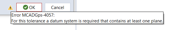

[Er...] Posted May 17, 2022 Share Posted May 17, 2022 (edited) Good afternoon, I work with GOM Inspect on a daily basis, and I must say that I am very happy. The software is extremely well thought out. However, there remains always something to be desired! When attempting to use an axis as a datum for a GD&T symmetry specification, the system responds as follows: However, ISO 1101, clause 17.15.1, only requires a "datum that locks a non-redundant translation of the tolerance zone". It does not mention the locking of rotations. Any axis locks 2 out of 3 non-redundant translations, so that should do. Are there any plans to support axes as a datum? Best regards, Edited May 17, 2022 Link to comment https://qualityforum.zeiss.com/topic/957-symmetry-specification-referencing-a-datum-axis-instead-of-a-datum-plane/ Share on other sites More sharing options...
[Ch...] Posted May 18, 2022 Share Posted May 18, 2022 Hello, an improved symmetry evaluation is one of the GD&T improvements that is coming with the upcoming major release of the GOM Software. This includes symmetry inspection to a datum line as well as other improvements to support the "symmetry" section inside the ISO 1101 in a much better way. Best regards Christoph Schult Link to comment https://qualityforum.zeiss.com/topic/957-symmetry-specification-referencing-a-datum-axis-instead-of-a-datum-plane/#findComment-2963 Share on other sites More sharing options...
