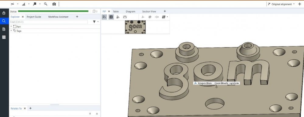

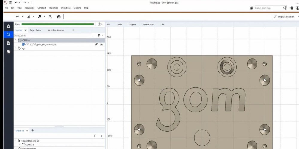

[Ti...] Posted May 21, 2022 Share Posted May 21, 2022 Complete newb here to GOM...doing the free training right now. The PIP never pops up for this girls voice teaching us newbies(see pic), but I cannot avoid a PiP(see my pic), maybe I'll see it as a weapon much later on, but I'm not looking to learn 2 different angles of attack right now. How do you disable this without cancelling it to the shadow realm and watching it disappear from the bar up top? Link to comment https://qualityforum.zeiss.com/topic/967-how-do-you-hide-the-pip-without-cancelling-it/ Share on other sites More sharing options...
[Be...] Posted May 24, 2022 Share Posted May 24, 2022 Hi, simply click on the tab bar (on the name 'PIP'). This toggles the visibility of the 3d window. If you close this window with an 'X' you can add this window again if you click at '+' sign. Hope this helps? Regards, Bernd Link to comment https://qualityforum.zeiss.com/topic/967-how-do-you-hide-the-pip-without-cancelling-it/#findComment-3039 Share on other sites More sharing options...
