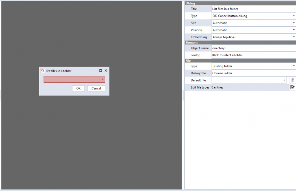

[Ma...] Posted May 25, 2022 Share Posted May 25, 2022 Hello, I have this script: # -*- coding: utf-8 -*- import gom import os RESULT=gom.script.sys.execute_user_defined_dialog (content='<dialog>' \ ' <title>List files in a folder</title>' \ ' <style>Standard</style>' \ ' <control id="OkCancel"/>' \ ' <position></position>' \ ' <embedding></embedding>' \ ' <sizemode></sizemode>' \ ' <size width="182" height="107"/>' \ ' <content rows="1" columns="1">' \ ' <widget rowspan="1" row="0" column="0" columnspan="1" type="input::file">' \ ' <name>directory</name>' \ ' <tooltip>Klick to select a folder</tooltip>' \ ' <type>directory</type>' \ ' <title>Choose Folder</title>' \ ' <default></default>' \ ' <limited>false</limited>' \ ' <file_types/>' \ ' <file_types_default></file_types_default>' \ ' </widget>' \ ' </content>' \ '</dialog>') dir = RESULT.directory for (basepath, subfolders, filenames) in os.walk(dir): for filename in filenames: base, ext = os.path.splitext(filename) if ext == '.stl': stlfile = os.path.join(basepath, filename) gom.script.sys.import_stl ( bgr_coding=True, files=[stlfile], import_mode='clipboard', length_unit='mm', stl_color_bit_set=False, target_type='mesh') if ext == '.g3d': g3dfile = os.path.join(basepath, filename) gom.script.sys.import_g3d ( files=[g3dfile], import_mode='clipboard') and with this I can import a "Existing Folder" with both stl and g3d files inside. But I have to modify this script to select "Multiple existing files". I have modified the dialog as shown in the images, but it doesn't work. Someone could help me? Thank you very much. Link to comment https://qualityforum.zeiss.com/topic/979-script-for-import-g3d-and-stl/ Share on other sites More sharing options...

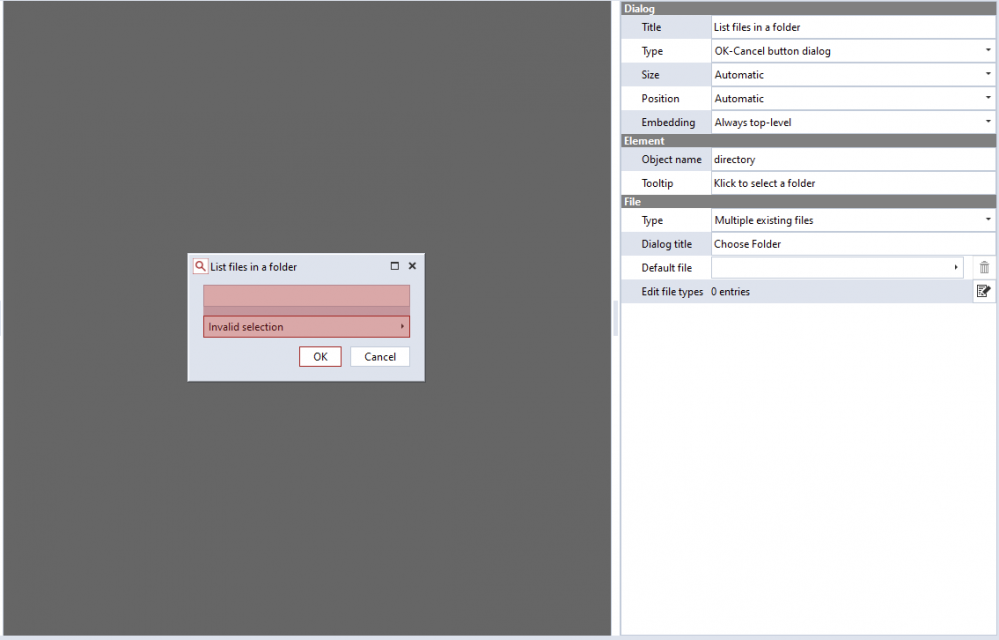

[Ma...] Posted May 31, 2022 Share Posted May 31, 2022 Hello, I've modified your script: # -*- coding: utf-8 -*- import gom import os RESULT=gom.script.sys.execute_user_defined_dialog (content='<dialog>' \ ' <title>List files in a folder</title>' \ ' <style>Standard</style>' \ ' <control id="OkCancel"/>' \ ' <position></position>' \ ' <embedding></embedding>' \ ' <sizemode></sizemode>' \ ' <size height="159" width="305"/>' \ ' <content rows="1" columns="1">' \ ' <widget columnspan="1" row="0" rowspan="1" column="0" type="input::file">' \ ' <name>directory</name>' \ ' <tooltip>Klick to select a folder</tooltip>' \ ' <type>multi_file</type>' \ ' <title>Choose Folder</title>' \ ' <default></default>' \ ' <limited>true</limited>' \ ' <file_types>' \ ' <file_type name="*.stl *.g3d" description=""/>' \ ' </file_types>' \ ' <file_types_default>*.stl *.g3d</file_types_default>' \ ' </widget>' \ ' </content>' \ '</dialog>') dir = RESULT.directory for filename in dir: print(filename) base, ext = os.path.splitext(filename) if ext == '.stl': stlfile = os.path.join(filename) gom.script.sys.import_stl ( bgr_coding=True, files=[stlfile], import_mode='clipboard', length_unit='mm', stl_color_bit_set=False, target_type='mesh') if ext == '.g3d': g3dfile = os.path.join(filename) gom.script.sys.import_g3d ( files=[g3dfile], import_mode='clipboard') Regards, Marcus Link to comment https://qualityforum.zeiss.com/topic/979-script-for-import-g3d-and-stl/#findComment-3095 Share on other sites More sharing options...
[Ma...] Posted May 31, 2022 Author Share Posted May 31, 2022 Please sign in to view this quote. You are an angel!!!! Thank you very very very much!!! Link to comment https://qualityforum.zeiss.com/topic/979-script-for-import-g3d-and-stl/#findComment-3097 Share on other sites More sharing options...
