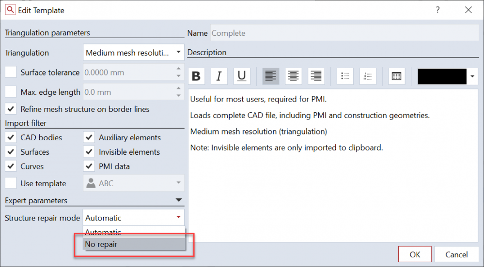

[Ja...] Posted May 25, 2022 Share Posted May 25, 2022 Hello, I keep getting an error when importing NX V1953 models. "Error MCADImport-0051 CAD converter message Cannot import the file: API has crashed. I am using GOM Inspect professional 2021 Hotfix 5 any ideas? Link to comment https://qualityforum.zeiss.com/topic/981-api-crash-on-cad-import/ Share on other sites More sharing options...
[Ja...] Posted May 30, 2022 Share Posted May 30, 2022 (edited) You could try to disable the CAD repair, which causes trouble sometimes. NX is supported up to 1980, so this should work. If it does not, feel free to contact our support and send us the file. You said that this happens quite often with NX 1953 models, so it would to great to have some of those files to see whats wrong. Edited May 30, 2022 Link to comment https://qualityforum.zeiss.com/topic/981-api-crash-on-cad-import/#findComment-3081 Share on other sites More sharing options...
