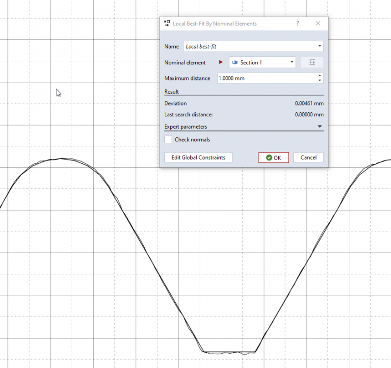

[Se...] Posted September 12, 2022 Share Posted September 12, 2022 Hi, To import nominal data, you can just drag and drop it. To get a section out of it, it can be projected into a plane: To inspect the measurement of complete curve, it can also be imported as a section. Again drag and drop, choose "Ascii text format" and Add to part. Template "curve" already exist, but in this case separators are commas. You can create a new template that handles this, and imports a section directly: Then you need to apply the measuring principle "Link to actual" to link both. For the alignment, a prealingment like "3 point alignment" and finally a better alignment like: For the incomplete section it is a bit more tricky. Could be imported as point cloud. Data is quite noisy already. I did it again as a section, perform a similar alignment, then do a Section deviation check with large point distance (to prevent points on the segments that close the non measured gaps to be part of the inspection) and a small search distance. Hope this helps. Sergio Link to comment https://qualityforum.zeiss.com/topic/999-2d-comparison/#findComment-4509 Share on other sites More sharing options...

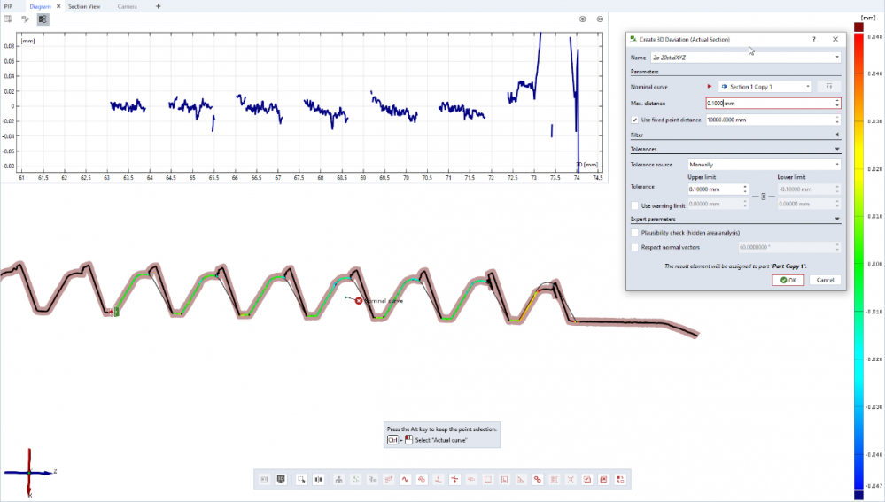

[Ba...] Posted September 13, 2022 Author Share Posted September 13, 2022 Great! Thank you 🙂 You have written that you imported noised profile as a cloud of points but I am not sure. Is it really point cloud or curve? I tried to do it as a points but in this way I cannot do the section as well as I cannot link nominal with actual data. How I can define cloud of points as an actual data and link it with nominal curve? I can import noised profile as a curve but it do not look good as you can see on the second picture. Maybe can I delete some noised points and after that generate curve? But the problem is I do not know how to do this in GOM. Regards, Bartek Link to comment https://qualityforum.zeiss.com/topic/999-2d-comparison/#findComment-4539 Share on other sites More sharing options...
[Se...] Posted September 14, 2022 Share Posted September 14, 2022 Hi, I mentioned that it could be imported as point cloud, I imported it however as actual section. To get rid of the noise, I created a 3D deviation (Actual section) with (see screenshot in previous post): - Max distance set to a meaningful value (this is how far the check looks for checking the distance) - Point distance larger than the artificial segments created between measured points, such that the check does not create additional points on them VG, Sergio Link to comment https://qualityforum.zeiss.com/topic/999-2d-comparison/#findComment-4547 Share on other sites More sharing options...
