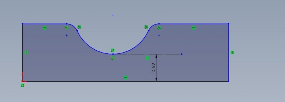

[Ti...] Posted July 12, 2022 Author Share Posted July 12, 2022 Please sign in to view this username. Thanks for the link, I can see that class....it is 620 the one I took is 780. Regardless, I'm happy you shared the link with me b/c I will take the class tonight. I'll have to investigate your idea of using a positional check. On the surface, I don't think a positional check works for getting the minimum distance b/w two surfaces. I understand you have to create a 'real' measurement principle. But, it just seems like you should be able to say 1) make a cylinder 2) apply guassian 3) make a plane 4) apply guassian 5) GET ME the smallest distance b/w the two features. Instead, you have to create the strategy in the above link I provides of making lines and points. I will have a look at your suggestion, but below is the dimension I'm looking for exactly to be clear. I appreciate your help with my early questions, thanks so much. Link to comment https://qualityforum.zeiss.com/topic/1118-building-feature-strategies-and-theory/#findComment-3727 Share on other sites More sharing options...
[Ja...] Posted July 13, 2022 Share Posted July 13, 2022 Tim, it is a bit more advanced i guess but one opportunity you have in the case in your image is a touch edge point to the rearside of the mesh. If you create a surface point, on the apex of the depression and choose an inverse surface normal you can have a touch edge loint touch the lowest point on the depression. You can then have a projected point distance from this tothe plane. You can have multiple of these perhaps and group them to understand the feature behaviour. The general issue you face issue is best summarised for me by thinking about measuring between two planes...there are infinite ways to do this if you consider that planes in real life will never be parrallel. Link to comment https://qualityforum.zeiss.com/topic/1118-building-feature-strategies-and-theory/#findComment-3731 Share on other sites More sharing options...
[Be...] Posted July 14, 2022 Share Posted July 14, 2022 Another simple possibility would be the Deviation to geometry and a minimum picker. Create the fitting plane and calculate the deviation of the cylindrical area of the mesh to the plane. Or you can calculate the Material thickness on this area which yields the deviations to the nearest triangle on the other side. But as already mentioned: The different strategies will give you different results and it depends strongly which value you like to evaluate. This depends which functionality you like to check (and therefore you must make this decision and the software can only offer different strategies). Regards Link to comment https://qualityforum.zeiss.com/topic/1118-building-feature-strategies-and-theory/#findComment-3761 Share on other sites More sharing options...

[Be...] Posted July 18, 2022 Share Posted July 18, 2022 Inspection -> Min/Max deviation label or in the I-Inspect if your deviation object is selected in the explorer Link to comment https://qualityforum.zeiss.com/topic/1118-building-feature-strategies-and-theory/#findComment-3799 Share on other sites More sharing options...
