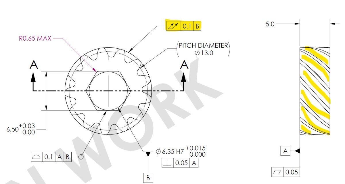

[Jo...] Posted May 27 Share Posted May 27 Hi All, Can anyone tell me how to program a total runout on a gear surface? What kind of feature should I use to get the best result and how should I evaluate it? Please see image from actual drawing. Thanks in advance! -Joe Barajas Link to comment https://qualityforum.zeiss.com/topic/26716-programming-a-total-runout-on-a-gear-surface/ Share on other sites More sharing options...

[Ch...] Posted May 28 Share Posted May 28 if you have the cad model it helps, from your gear 'GAP' alignment, rotate 1/2 gear pitch, since yours appears to have 13 teeth, rotate 13.846° from the gap alignment at the same Z height as gap alignment. Program a point with proper vector (easier from CAD - also your CAD should have a gap or tooth aligned with X or Y). Rotational Pattern the point 13x , angle = 27.692° (360/13) . Recall points in to circle - report runout. If you don't have rotary table suggest coming straight down with down probe. With the pattern, it should take care of clearance planes. Good luck ! 1 Link to comment https://qualityforum.zeiss.com/topic/26716-programming-a-total-runout-on-a-gear-surface/#findComment-151274 Share on other sites More sharing options...

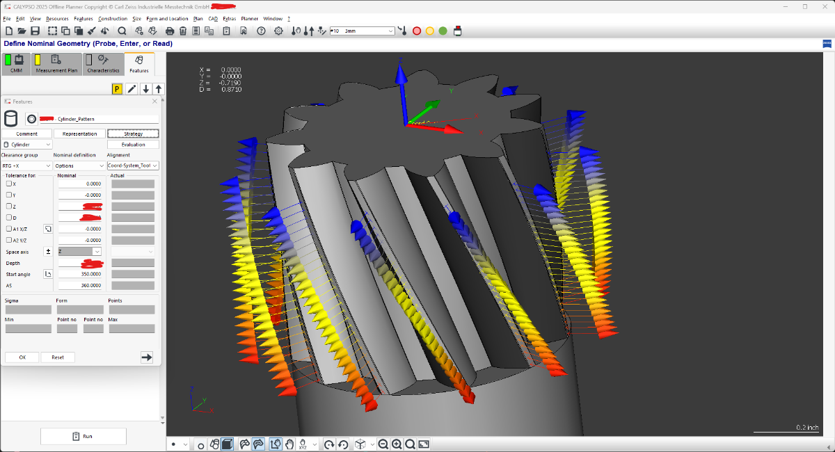

[Ch...] Posted May 29 Share Posted May 29 Richard is correct, for total runout the entire OD surface should be included, and I have done this, but thought it might be a bit much for you. I think there are a few ways to get the helical paths on the teeth, since he is showing a cylinder probably a helix path strategy. A more common simpler approach might be to check top middle bottom of the OD. Keep in mind for this, due to it being a helical gear, you will either need to calculate the twist offset alignment, which is possible, but for a beginner I just suggest finding the gap in 3 places, top, middle, bottom. Good luck ! 1 Link to comment https://qualityforum.zeiss.com/topic/26716-programming-a-total-runout-on-a-gear-surface/#findComment-151358 Share on other sites More sharing options...
[Ch...] Posted May 29 Share Posted May 29 For a helical strategy I think it would be best to have the CAD aligned (e.g. gap aligned to X or Y), so you can make sure all traces will be on tooth tips, etc. Let us know how you make out ! 1 Link to comment https://qualityforum.zeiss.com/topic/26716-programming-a-total-runout-on-a-gear-surface/#findComment-151362 Share on other sites More sharing options...
