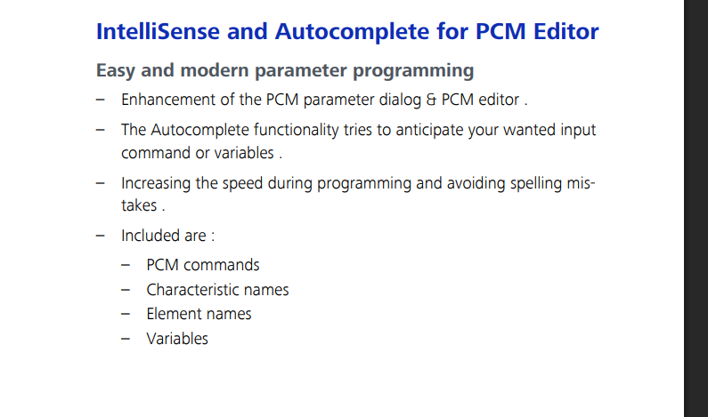

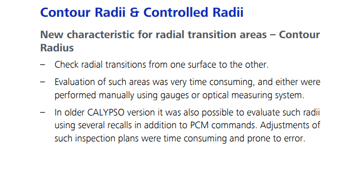

[Ch...] Posted May 5, 2025 Share Posted May 5, 2025 I was literally just thinking of this one... if they know small arc radii are tough to calculate, why not build in the logic ?? 2 Link to comment Share on other sites More sharing options...
[Ch...] Posted May 5, 2025 Share Posted May 5, 2025 ooohhh baby... 2 1 Link to comment Share on other sites More sharing options...

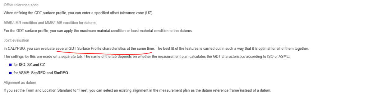

[Ro...] Posted May 5, 2025 Share Posted May 5, 2025 Please sign in to view this quote. That is the part I am most interested in. 2 Link to comment Share on other sites More sharing options...

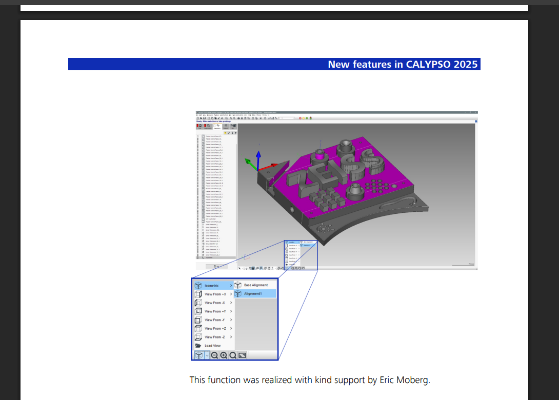

[Je...] Posted May 5, 2025 Share Posted May 5, 2025 Please sign in to view this quote. I had wondered for years if Eric was indeed Lord Calypso. Brilliant programmer. I wish he's post content more often. Link to comment Share on other sites More sharing options...

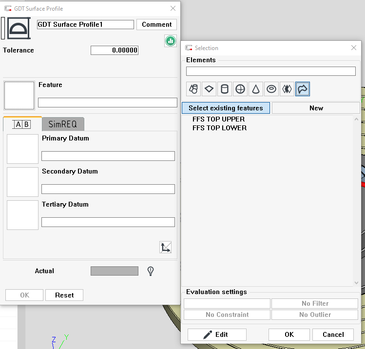

[Ri...] Posted May 5, 2025 Share Posted May 5, 2025 Can we use Free-Form Surface in the new Profile again? Link to comment Share on other sites More sharing options...
[Ch...] Posted May 5, 2025 Share Posted May 5, 2025 it appears so ... 1 Link to comment Share on other sites More sharing options...

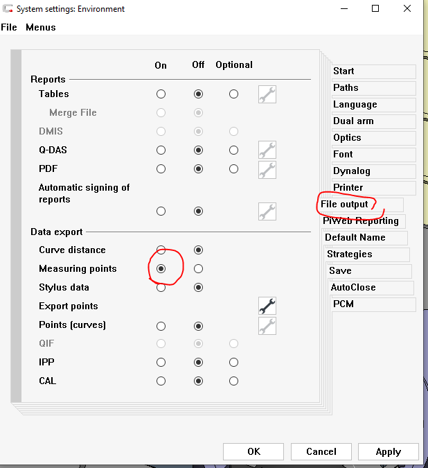

[Ch...] Posted May 5, 2025 Share Posted May 5, 2025 and we can FINALLLYYYY turn on measuring points by default globally... 2 Link to comment Share on other sites More sharing options...

Popular Post [Je...] Posted May 6, 2025 Popular Post Share Posted May 6, 2025 Here's a quick summary of improvements in Calypso 8.0 that I made based on the release notes. Nice work, Zeiss! Calypso 8.0 – Summary of Improvements Improvement Pages Description Notes Datum Calculation to ISO 5459:2024 2-2 Supports latest standard for datum and alignment calculation, propagates to all alignments in a plan. Activated via Settings → Measurement → Form Datum. GD&T Engine Updates 2-3 Updated to meet newest standards, SIM support added, UI streamlined. Now easier access via main menu. Line/Surface Profile with UZ 2-4 UZ offset directly specifiable—no longer needs manual calculation. Streamlines GD&T programming. PiWeb Point List Output 2-5 Export min/max deviations or individual deviations with tolerances to PiWeb. Helpful for documentation and visualization. Angularity w/ Nominal Direction 2-6 Allows manual input of nominal direction on angularity characteristics. Enhances flexibility. GD&T Best-Fit Alignment 2-6 to 2-7 Use GD&T results to calculate best-fit coordinate systems for subsequent evaluations. Located at Resources → Utilities. Waviness Plot Enhancements 2-8 Supports harmonic selection and enhanced plots in PiWeb. Helps in surface texture analysis. PMI Import Enhancements 2-9 Expanded PMI capability from major CAD platforms. Supports SolidWorks, NX, Creo, etc. UUID/QPID Import/Export 2-10 Enables tracking of characteristics across systems via UUID/QPID. For traceability and digital thread. Simulation Improvements 2-17 to 2-18 RT-AB settings available in simulation; new CALYPSO Planner improves simulation performance. More efficient offline programming. Automatic Entity Update on Freeform Patterns 2-19 Entities auto-update with pattern changes on freeform surfaces. Speeds up parametric updates. Contour Radii / Controlled Radii Characteristic 2-20 New method to evaluate blended radial transitions. Reduces manual gauge work or complex recalls. Optical CMMs + NEO Server Upgrades 2-21 Streamlined stylus system management, magnification toggles, illumination compatibility. Significant UI and workflow gain. OCR Characteristic (Text Reading) 2-22 Read alphanumeric text from workpiece and compare to nominal string. Adds traceability and part verification options. Code/Text Nominal Comparison 2-22 Validate content and readability of barcodes and text (including from mosaic images). Boosts automated ID verification. Laser Sensor RC-CAA Qualification 2-23 LineScan sensors qualify faster (~18 min) with no accuracy loss. Less downtime, easier handling. Reset CAD Transform Offset 2-16 Resets CAD model offset after applying transformation to avoid cumulative misalignment. Simple but vital UX improvement. SoftTouch Mode & Visual Indicators Not detailed Assumed to refer to stylus pressure sensitivity and new UI feedback cues. Further exploration in UI may be required. IntelliSense & Autocomplete for PCM Not listed but inferred Smarter programming via contextual code suggestions in the PCM editor. Increases programming efficiency and reduces error. (Not official or comprehensive) 6 1 Link to comment Share on other sites More sharing options...
[Ch...] Posted May 6, 2025 Share Posted May 6, 2025 Jeff, I like it, looks cleaner than the official release notes, in my own opinion of course... I like the pattern on FFS. Link to comment Share on other sites More sharing options...

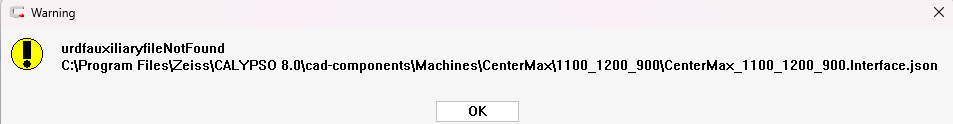

[Ro...] Posted May 6, 2025 Share Posted May 6, 2025 I just tried to run planner and it gives me the error "machineDoesNotExist" along with another error. Link to comment Share on other sites More sharing options...

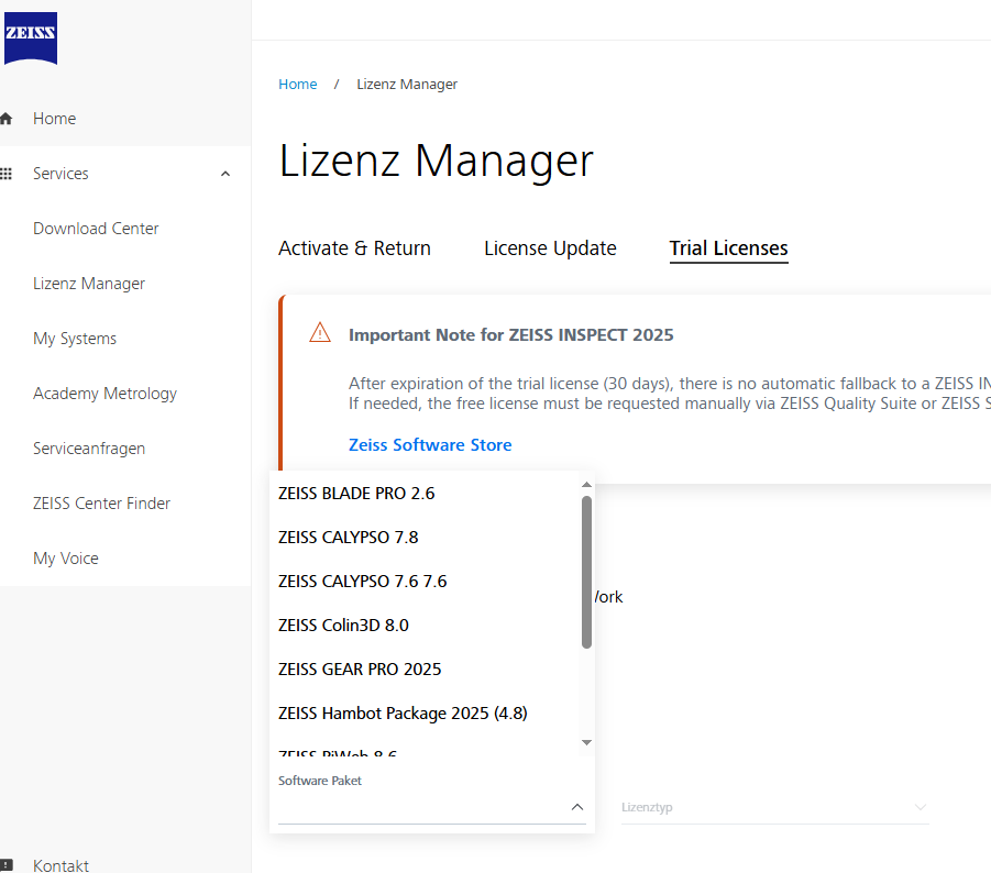

[Fl...] Posted May 7, 2025 Share Posted May 7, 2025 Trying to get a trailLizenz 😮 Link to comment Share on other sites More sharing options...
