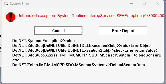

[Ro...] Posted May 6 Share Posted May 6 (edited) I just tried importing an SSC file, for an XTR stylus system, and I get an error every time. It is sad that 8.0 is still so broken. Edit: Created a machine from scratch, after more unhandled exception errors and software restarts, and the import worked, but the Z values from my PCF not so much. I guess I need to rebuild all of my machines from scratch, for 8.0. Edit #2: Very next one gave same error. Apparently it doesn't like ConturaXTR for the name. ConturaXTR1, it works. 🤦♂️ Edited May 6 2 Link to comment https://qualityforum.zeiss.com/topic/23333-calypso-80/page/6/#findComment-150194 Share on other sites More sharing options...

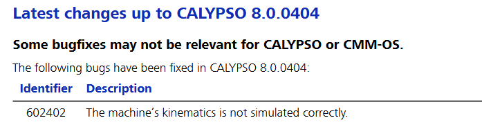

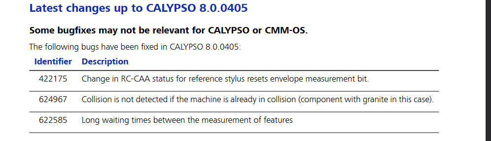

[Ka...] Posted July 9 Share Posted July 9 Please sign in to view this quote. Whether this is actually a major functional breakthrough...?? The main problems were performance, 3D models of all CMMs, 100% detection of all collisions, measurement range overshoot with RDS XXT, memory leaks, and a whole host of other issues. From Release notes of 8.0.16: 795786 In the CAD simulation, collision detection is now set to very high accuracy by default. 803828/809372 Curve with a turntable. In the CAD simulation, the turntable is rotating in the wrong direction 817080 CAD simulation. Contura G2 does not work directly with XXT. 818704 The wrong stylus is displayed in the CAD simulation. If a stylus system is present, it will be displayed; otherwise, the (stored) reference stylus system is displayed. 823312 URDF files and the faceting of the button simulation have been revised. The display and performance of the CAD simulation have been improved. 862756 The CAD simulation does not work properly if file paths contain special characters, such as the sharp S (ß). 863099 An incorrect position in the CAD simulation during the calculation of the measurement range in the Z-direction has been corrected. 867088 The Prismo 16/24/10 was not displayed correctly in the CAD simulation 1 Link to comment https://qualityforum.zeiss.com/topic/23333-calypso-80/page/6/#findComment-152649 Share on other sites More sharing options...
