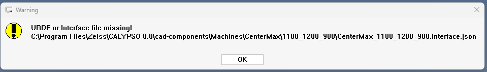

[Wo...] Posted August 18, 2025 Author Share Posted August 18, 2025 Please sign in to view this quote. I have installed Calypso on a new PC that did not have it ever, created a new machine and the same thing happened - simulation is so slow it's unusable. Link to comment https://qualityforum.zeiss.com/topic/23333-calypso-80/page/4/#findComment-136893 Share on other sites More sharing options...

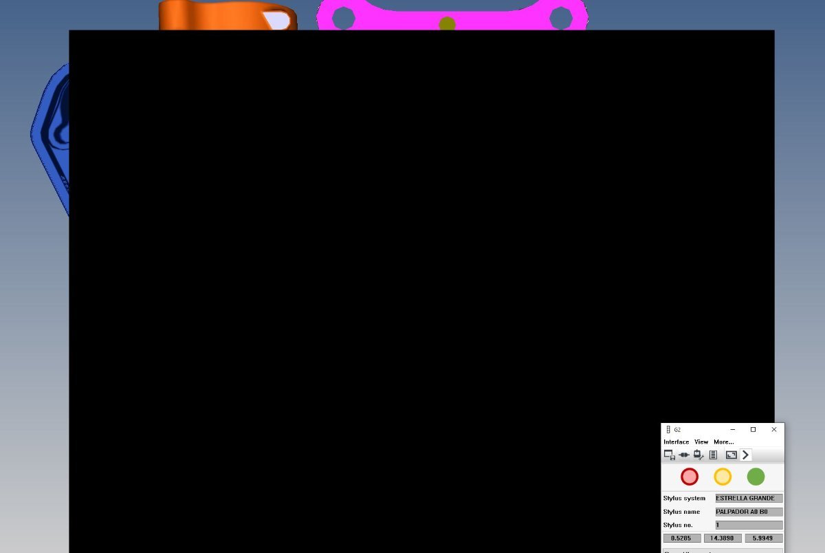

[HE...] Posted August 19, 2025 Share Posted August 19, 2025 Has anyone experienced problems with the new version of Calypso 8.0? When programming a part, the CMM does not move, it stays static, or it moves but looks for the part in another location, among other errors. Link to comment https://qualityforum.zeiss.com/topic/23333-calypso-80/page/4/#findComment-136981 Share on other sites More sharing options...

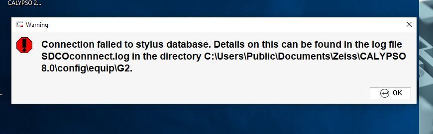

[Ma...] Posted August 19, 2025 Share Posted August 19, 2025 I would doubt if it's software related. Stylus database is from local MS SQL server. I would ask IT if there were changes on their side or windows update / antivirus update. I would suspect event lan cable to the internet. I only faced stylus error due being too fast after start of the system and mssql didn't run yet due service settings Link to comment https://qualityforum.zeiss.com/topic/23333-calypso-80/page/4/#findComment-136985 Share on other sites More sharing options...

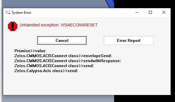

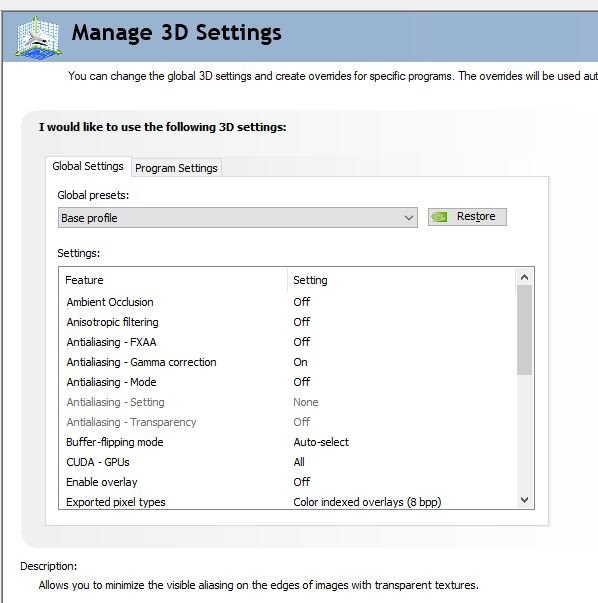

[Wo...] Posted August 19, 2025 Author Share Posted August 19, 2025 The WSAECONNRESET usually went away for me by setting Nvidia profile to "Autodesk Motion Builder compatible". Can't help with SDCO, maybe AV is blocking access to the file? Link to comment https://qualityforum.zeiss.com/topic/23333-calypso-80/page/4/#findComment-137001 Share on other sites More sharing options...
[HE...] Posted August 19, 2025 Share Posted August 19, 2025 THANKS FOR SHARING THE INFORMATION, I WILL TRY TO MAKE THESE SETTINGS AND WILL DESCRIBE CHANGES IN THE FUTURE, I FOUND BASIC PROFILE IN MY NVIDIA SETTINGS, I WILL CHANGE TO THE RECOMMENDATION Link to comment https://qualityforum.zeiss.com/topic/23333-calypso-80/page/4/#findComment-137005 Share on other sites More sharing options...

[Ro...] Posted August 21, 2025 Share Posted August 21, 2025 Finally found the time to install the service pack. Still cannot use simulation for my Centermax. 1 Link to comment https://qualityforum.zeiss.com/topic/23333-calypso-80/page/4/#findComment-137157 Share on other sites More sharing options...
[Ja...] Posted August 21, 2025 Share Posted August 21, 2025 FWIW - Just installed the latest patch. Simulation is still a disaster. 1 Link to comment https://qualityforum.zeiss.com/topic/23333-calypso-80/page/4/#findComment-137169 Share on other sites More sharing options...
