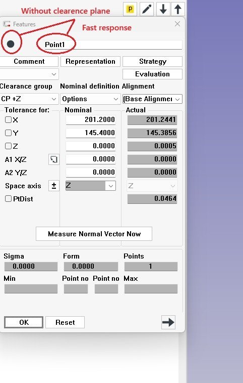

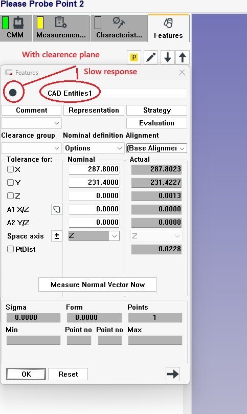

[Ma...] Posted June 24, 2025 Share Posted June 24, 2025 Hello Wojciech I have the exact same problem. I found that when the clearence plane is activated makes the registration of features extremely slow. If you set the clearence plane to zero, as if it hasn't been set yet, features will be recognized fast as in 7.8 3 Link to comment https://qualityforum.zeiss.com/topic/23333-calypso-80/page/3/#findComment-134263 Share on other sites More sharing options...
[Ch...] Posted June 24, 2025 Share Posted June 24, 2025 Please sign in to view this quote. I'll telling you guys, Zeiss changed something in the background with clearance planes ever since service pack 7.8.12. See my post: Blank clearance planes giving error after installing service pack 7.8.12 and also in Calypso 8.0 3 Link to comment https://qualityforum.zeiss.com/topic/23333-calypso-80/page/3/#findComment-134277 Share on other sites More sharing options...

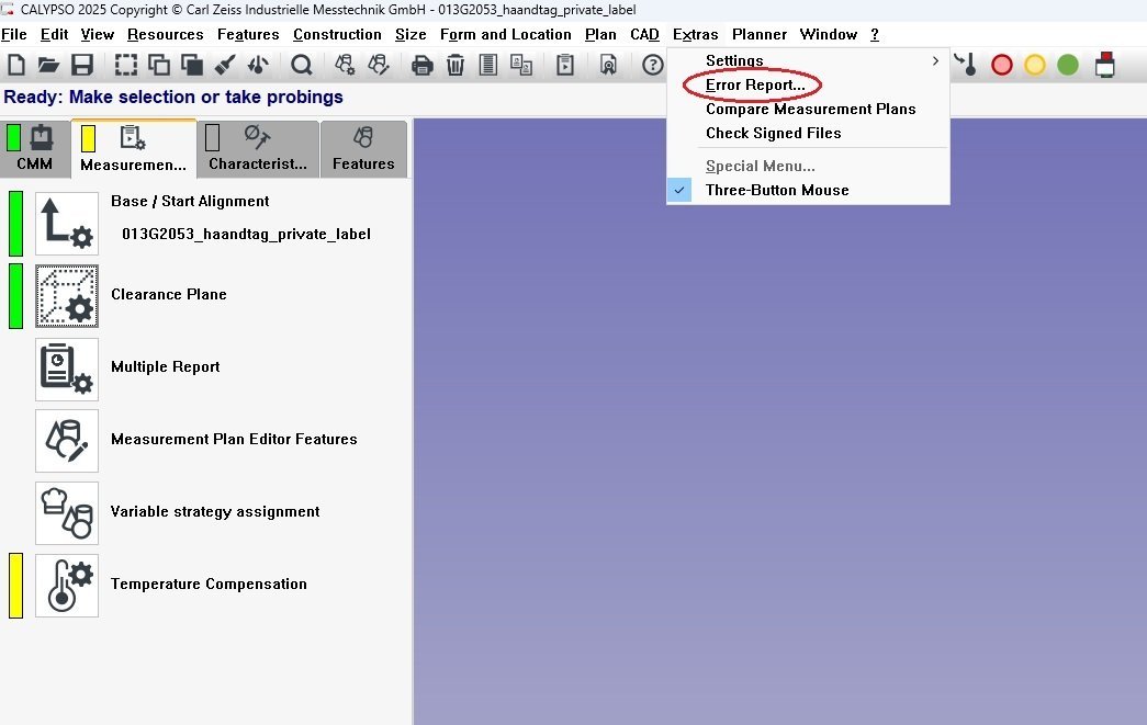

[Ma...] Posted July 1, 2025 Share Posted July 1, 2025 Please sign in to view this quote. Hi Wojciech I was just contacted by my local Zeiss support. They are on the case, and wanted a screen dump on the firmware of my machine. The firmware on my machine, which lags, is V31.22. with RDS probe installed The other machine, which works, has V31.23 with VastXT probe installed. You can find your firmware version under Extras - Error report May be firmware related - I'll keep you updated. 1 Link to comment https://qualityforum.zeiss.com/topic/23333-calypso-80/page/3/#findComment-134539 Share on other sites More sharing options...
