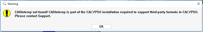

[Cl...] Posted May 7, 2025 Share Posted May 7, 2025 After the install, this will occasionally pop up. Any ideas why? Link to comment Share on other sites More sharing options...
[Ch...] Posted May 7, 2025 Share Posted May 7, 2025 I believe mine got auto installed with the main install. I think it is in the install folder and you may be able to install it yourself. There is a .msi in the install folder. Good luck. Link to comment Share on other sites More sharing options...

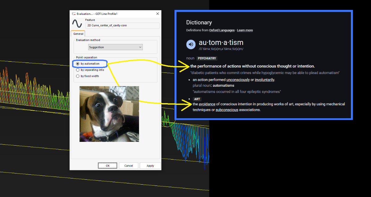

[Je...] Posted May 7, 2025 Share Posted May 7, 2025 Language (and translation) matters 👨🎓📚 I think I can deduce what Zeiss means by "automatism" here, but the dictionary definitions make it sound more like me before coffee ☕ in the morning. I pledge to use this word more often. Perhaps they should use the word "magic" instead. 4 Link to comment Share on other sites More sharing options...
[Ch...] Posted May 7, 2025 Share Posted May 7, 2025 Jeff - I looked up the exact same thing... was going to post something as well, didnt want to offend anyone tho. Link to comment Share on other sites More sharing options...

[No...] Posted May 8, 2025 Share Posted May 8, 2025 Please sign in to view this quote. Swabian programmers shouldn't be allowed to do English translations themselves. 😆 Here's why (Günther Oettinger's "English" was legendary 😄) 2 1 Link to comment Share on other sites More sharing options...
[Ja...] Posted May 8, 2025 Share Posted May 8, 2025 Please sign in to view this quote. I always think of this old ad when it comes to German/English translation: 2 1 Link to comment Share on other sites More sharing options...

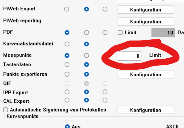

[Da...] Posted May 14, 2025 Share Posted May 14, 2025 just saw that there no option to set a limit for exporting mesurement points. is this feature completely gone? ususally we set limit to 10 points 1 Link to comment Share on other sites More sharing options...
[Ni...] Posted May 14, 2025 Share Posted May 14, 2025 I have not been able to find the setting yet. I was going to run a quick test when I get the chance to make sure it isn't at a (low) limit. We used to have ours set at 999 because that was the max. They changed that at some point through updates, so we updated the setting to 100,000. 1 Link to comment Share on other sites More sharing options...
